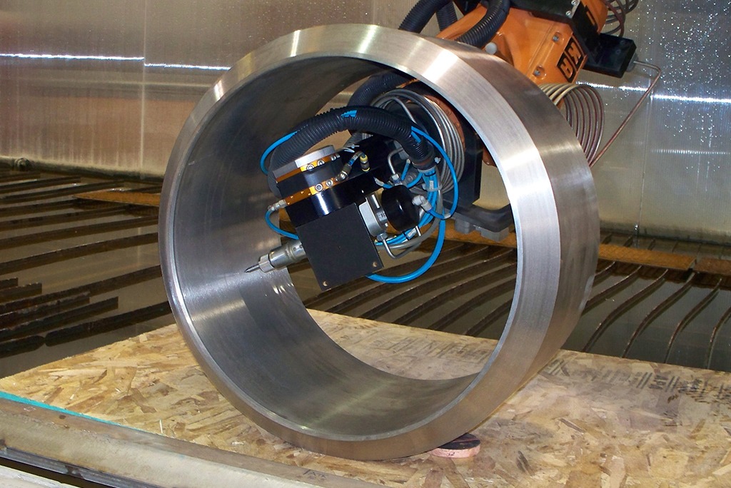

The water jet system can cut nearly any shape from materials ranging from 1/8” to 8” thick, with a radius as tight as 0.020”, and tolerances up to +/- 0.005”. The sixth and seventh axis robotic heads can cut in virtually any direction owing, in part, to their inverted position. The sixth and seventh axes allow the robot to move along a cut path of 24’ rather than perhaps 10’.
Nate Scoffield, head machine programmer pointed out that the longer cutting path allows more parts to be machined at one time. When combined with the router, the robot provides additional cutting and drilling functions.
