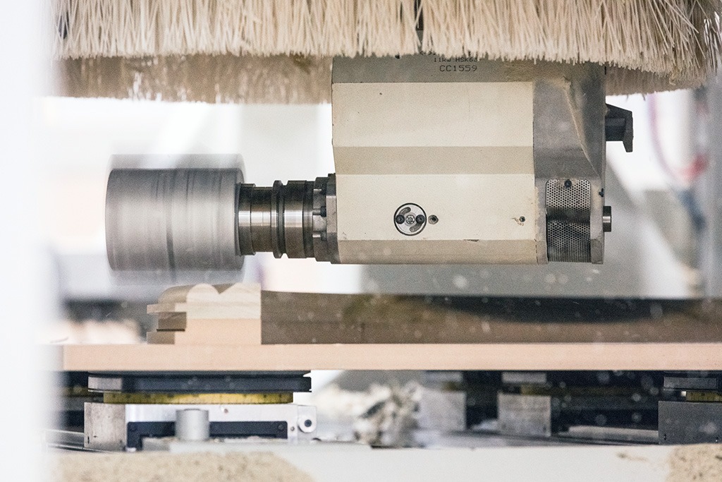

Because every wood species has different characteristics, programmers must consider the properties of a particular species and determine its response to manufacturing strategies. For a complicated project, a Fetzer programmer often uses a 5-axis CNC machining center and works closely with an operator to come up with a process to position parts and machine them in a way that is sustainable throughout the project.
“We work inside of Mastercam directly, producing the code that the machine then runs,” said Musser. “The software has a lot of built-in features for working with multiaxis machines. It allows us to cut those crazy miters and figure out the logistics of how thick, how wide, how to get an angle, and how to reproduce a part.”

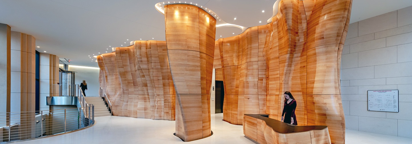

“Two years ago, we had quite a large project made from bass wood that was meant to replicate a slot canyon look,” said Musser. “Thousands of parts had to be individually programmed. We were looking at the numbers—we just weren’t going to hit the deadline or the budget. It was going to be too big of a project.”
Fetzer programmers found a solution in Mastercam APIs. They were able to identify repetitive parts, which allowed them to streamline and automate the entire process. CNC Software, Inc. has a dedicated team responsible for development, support, and promotion of its software development kits (SDK). Mastercam add-ins are known as C-Hooks written in C++ and NET-Hooks written in .NET using C# or VB.NET. The SDK team assisted on several Fetzer projects, including input on SDK libraries to help to develop the woodworker’s own Mastercam add-ins. Once the CNC team identified Fetzer Architectural’s needs, it supplied code and project examples to the manufacturing team.
“Mastercam API technology allowed us to actually reduce the programming time to a fraction of what it would have been,” said Musser. “CNC programming time was reduced by 75 to 90 percent.”
