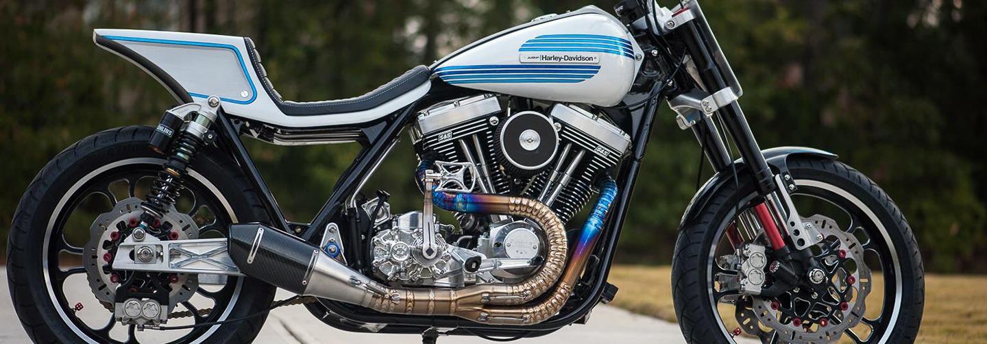

Michael Kamalian started out like any other motorcycle enthusiast. But when his love of bikes turned into a growing business, he started gaining attention from major motorcycle designers, magazines, and even television shows. Revolution Speed, located in Marietta GA, can create anything from a dream bike to simply customizing a daily driver. The company likes to state: “If you can think it, we can make it.”

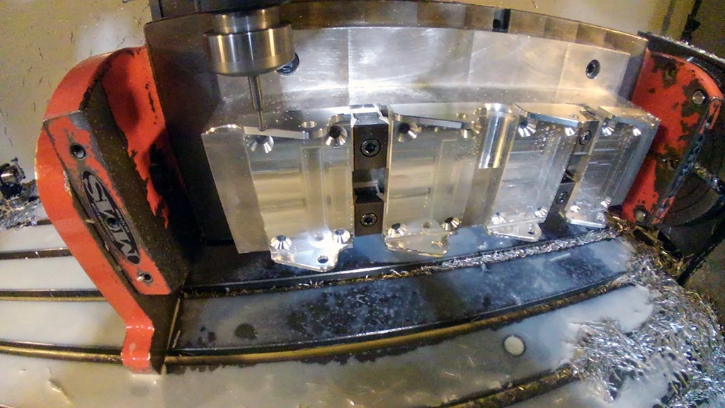

Lowe keeps things moving by running both mills at the same time to move the parts out faster and start the next project. High productivity is critical. In order to maximize time, machines are run at 12,000 to 15,000 RPM to achieve 200 to 500 in/min in aluminum with a 20 to 40 percent stepover.
Lowe pushes one of his vertical machining centers to its fullest potential by implementing Dynamic Motion technology. Dynamic Motion, or Dynamic Milling, uses proprietary algorithms programmed into the software to keep the tool constantly engaged with the material, allowing it to cut intricate geometries at higher speeds. “As we started doing the Dynamic toolpaths, the smaller vertical mill started catching up to the bigger machine a bit,” recalled Lowe. “We’ve been able to do a lot more jobs on this machine because I can get the cycle times down to where I need them to be.” According to Lowe, the machine peels off much more material, eliminating the need to step speeds down incrementally. “It’s helped make a machine that had almost become obsolete for us come back into being useful.”

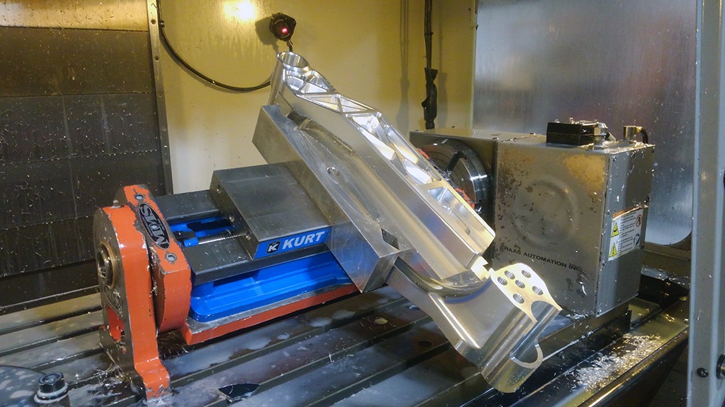

The software has proven successful when programming certain parts. Multiple customers have asked for a swing arm, the rear suspension piece on a motorcycle machined from two or three pieces where everything bolts together like a puzzle with pins and bolts. The machining for this part entails multiple angles, different pockets, pockets on angles and radiused edges, which all must be smooth.
“For this 6061-aluminum piece, I use the Parallel toolpath to get a nice cosmetic surface,” Lowe said. “I have about nine operations where we’re doing different angles and I’ll nest the two halves together and machine them out and then cut them apart on the band saw once they are almost finished. I use both Flowline and Parallel toolpaths for these operations. I’ve also used a lot of the high-speed Dynamic toolpaths for roughing.”
They started with a 70 lb. block of aluminum, whittling it down to about 11 lbs. “With these parts, I used to program a ramp toolpath and have a chunk of aluminum to pull it out, leaving a portion of it solid so I wasn’t turning it all into chips. Now, I’ve gotten to where I use the high-speed toolpaths to turn it all into chips so I don’t have to stop and pull the tool out or worry about it getting caught in the chip auger.”
