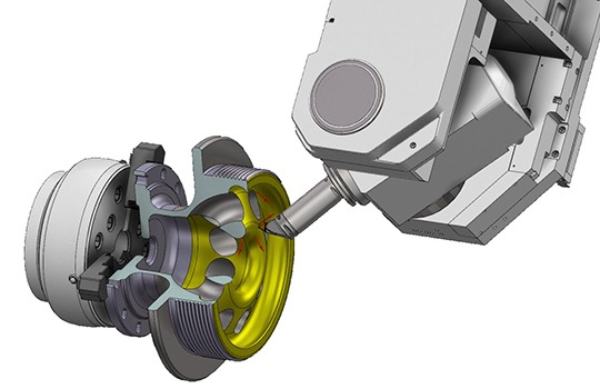

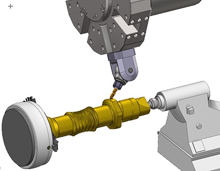

2. Turret Mounted Angled Milling Heads
You can now use turret-mounted angled milling heads in Mill-Turn operations, allowing you to create toolpaths on angled planes using turret-mounted tools. Enjoy enhanced productivity and ease of use for both milling and turning operations within the Mill-Turn environment.

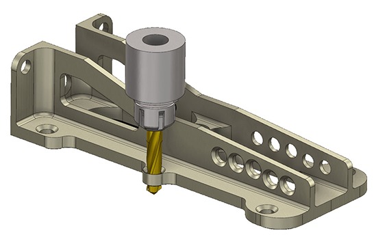

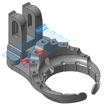

3. Process Hole Improvements
The process hole toolpath applies previously defined processes to a part’s solid hole features, which consists of one or more holemaking operations’ built-in functions library. The ability to import applicable processes into the working part file will save time and money while maintaining consistency with your processes.
4. Holemaking Enhancements
A “display graphical elements” button has been added to the holemaking and multiaxis toolpath dialog boxes, allowing users to show or hide graphical elements, such as selected geometry colors and graphical planes, depending on the toolpath type. This allows for more customized control on a hole-by-hole basis or across the entire holemaking toolpath, giving you a quick visual aid for toolpath creation and troubleshooting.

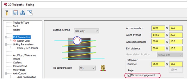

5. Dynamic Motion – Maximize Engagement
The Dynamic Mill, Face, and Dynamic OptiRough toolpaths now include a new Maximize engagement option, which produces more nominal chips, minimizes the number of small chips, and helps prevent problematic stand-alone material slivers. Additionally, Mastercam moves towards the entered Stepover as quickly as possible, helping to extend tool life, reduce vibration, optimize heat generation, promote healthy chip evacuation, and reduce overall machine wear.

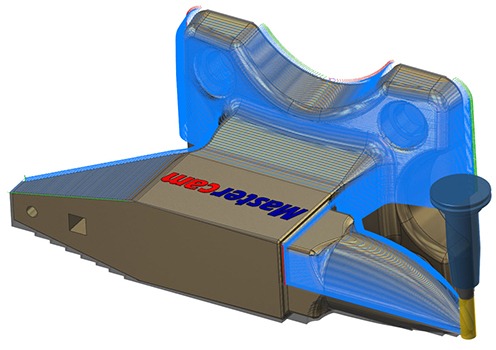

6. Waterline Enhancements
Waterline toolpaths are now aware of undercut stock conditions, resulting in improvement to the toolpath motion and less air cutting.

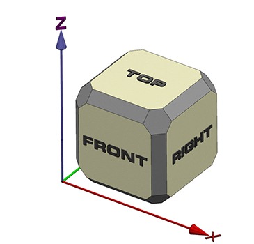

8. Gview Cube – New On-Screen Gnomon
Mastercam’s traditional on-screen gnomon has been augmented with the new Gview cube, which is a more graphical way to show plane orientation. With many interactive features, the optional Gview cube is relative to the WCS by default and features many options that allow you to control the cube and on-screen representation of the part.

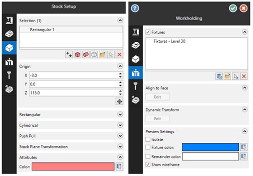

9. Machine Group Setup Stock Updates
Three new easier, more intuitive selection methods have been added, including Add from two corners, Add rectangular stock, and Add cylindrical stock. Stock definition is the first thing a user must do, and these new stock definition methods simplify and speed up the process while creating a better user experience.

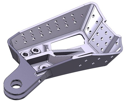

10. Solid Hole Enhancements
New solid hole enhancements include matching edge treatments for top and bottom edges, changing the direction of existing through holes, and creating new solid operations from a single existing hole operation. These represent more flexibility, fewer clicks, and time savings when creating geometry for holemaking operations.
