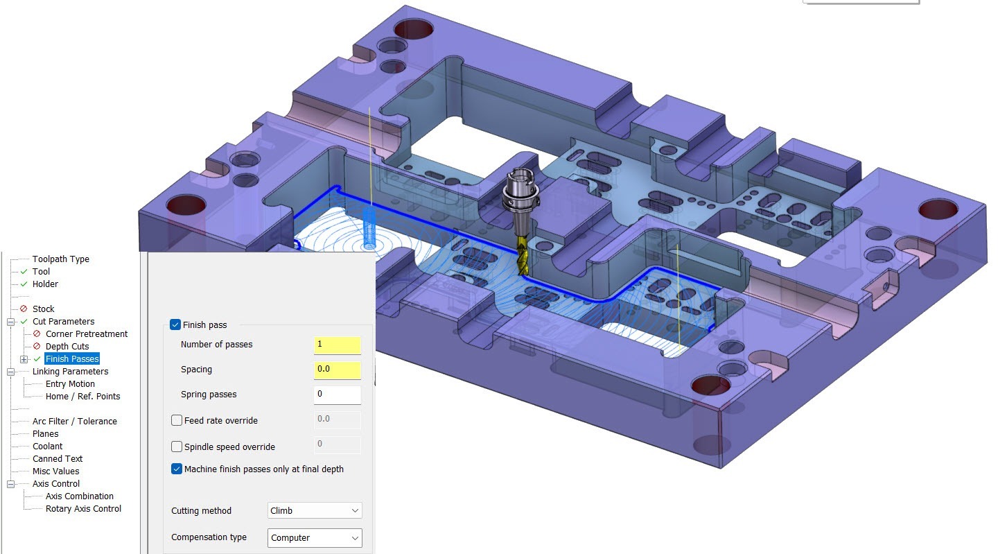

With the integration of finish passes into Mastercam 2025, users can now clean up these residual marks with ease. Let’s take a closer look at how this feature works:
Configuring Finish Passes: When setting up your toolpath, you can now activate finish passes and specify the amount of material to leave for finishing. For instance, setting a 0.5 mm offset for a single finish pass will ensure that the toolpath is adjusted to remove the remaining material with precision.
Finish Pass Settings: Mastercam 2025 offers a variety of finish pass settings to fine-tune your operation. These include options for spring passes, which help in achieving a smoother surface, feedrate overrides, and adjustments for cutting methods and compensation types. These settings allow you to customize the finishing process to meet the specific requirements of your job.
Lead-In and Lead-Out Options: The software also includes an extensive range of lead-in and lead-out settings. These controls dictate how the tool enters and exits the finishing pass, ensuring smooth transitions and reducing the risk of surface imperfections.
Toolpath Recalculation and Safety
Once you enable finish passes and regenerate your toolpath, you’ll notice the addition of extra toolpath motions designed to clean up the walls and remove the residual material. This recalculated toolpath helps in achieving a more refined surface finish, addressing any leftover tool marks.
However, dynamic toolpath motion can sometimes present challenges, especially if the tool does not fully engage with the material due to the radius or shape of the geometry. In such cases, the “Minimize Burial” option ensures that the tool remains in a safe operational environment, mitigating potential risks associated with toolpath engagement.
