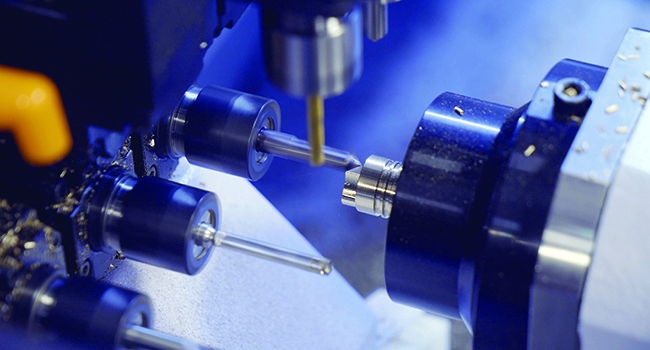

The two features that make a lathe a standard Swiss lathe are the guide bushing and the sliding headstock. The bar stock is turned rapidly while advancing through the guide bushing. This bushing provides the support necessary to eliminate deflection. The sliding headstock is what holds the stock material and slides along the guideways on the machine’s bed. The tool remains stationary and cuts close to where the material is held.
By keeping a stationary cutting tool parked rigidly 2mm away from stock and allowing stock to pass through the tool, Swiss users can cut very long, small diameters. A key to performing this lies in the condition of the stock. When utilizing a guide bushing, it is imperative to use ground stock or SMQ (Screw Machine Quality) stock. Remember, you cannot turn a round part with material that is out of round. Guide bushing diameters are typically ground to +/- .0002 or better. It is recommended that if you are running .4375 ground stock you should use a .4375 diameter guide bushing.
The newest Swiss machines can be run in Hybrid or Chucker mode, in which the guide bushing is removed from the machine. There are also machines with a turret or gag slide that move tools into stationary stock, but the vast majority of Swiss machines do still have guide bushings and move the stock to the tool. In any Swiss machine, the turning tool maintains a constant distance from the point of support to minimize deflection.
