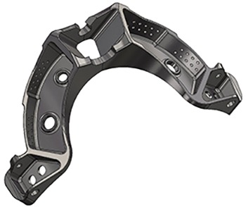

January 4, 2022 (Tolland, Conn.) – Multiaxis machining can dramatically increase a shop’s competitiveness. Mastercam Multiaxis is an add-on for Mastercam Mill 3D, Router 3D, Mill-Turn, and Mastercam for SOLIDWORKS®. It improves productivity with simultaneous 4- and 5-axis machining capability for Mastercam. Mastercam Multiaxis offers a wide range of multiaxis machining strategies, both basic and advanced. These toolpaths are also useful for advanced control of 3-axis machines.
Mastercam Multiaxis
